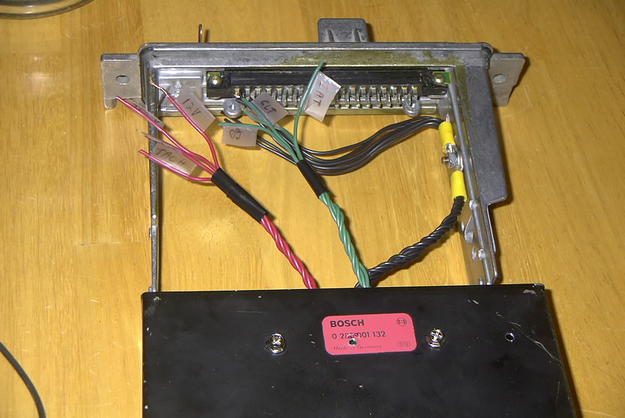

By Justin on Wednesday, November 10, 2004 - 05:38 pm:
Steven R
I have been using your MS guide and have hooked it up to the simulator and a pc and every thing seams to work except for the fuel pump light on the simulator. I have used your fuel pump drive circuit mod. (page 19. version 3.1 your guide) which is probably why the simulator led does not go on. Picture bellow.
I put a multi-meter across the IN4001 diode where it goes into hole 19 on DB37 and I get 0.01v.
My question is how do I know if I have this modification working before I put it into the car? And which way does the IN4001 go around or does it not matter?
By Steve R on Thursday, November 11, 2004 - 02:19 am:
Hi Justin,
Sorry about the lack of clarity in that part of the guide (I'm a poor proof reader!) - hope the rest helped.
From memory the fuel pump light on the stim doesn't work after the mod.
I'll have a look at mine when I get home this evening & post what the voltages are, I'll also clarify the orientation of the diode and the upside down transistor... both are important.
By Steve R on Thursday, November 11, 2004 - 01:40 pm:
Hi again Justin,
Just had another look at mine:
The IN4001 orientation is NON-banded end to hole 19 on the DB37. If I look at the upside down transistor from exactly the same orientation as your photo I see the FLAT side of the transistor facing me and the curved side (with the writing) faces away. From the above photo I think yours may be the wrong way around? Q3 looks OK. With this mod the fuel pump LED doesn't light on my board in the car either, but the pump runs fine.
Afraid I can't give you a decent multimeter test on the stim as this mod is purely to interact with the cars L-jet combo relay and not the stim. Check the component orientations as above and you should be OK in the car.
Hope this helps
By Peter Webb on Thursday, November 11, 2004 - 01:49 pm:
You can hot-wire the fuel pump on ignition if you have trouble with it. Just to verify that's what the problem is and to make the car run.
To hot wire the FP, take the connector off the AFM and jumper the 2 right most pins together as standing at the fender looking across the engine bay. You won't have IAT with the cable unplugged. The IAT is in the AFM.
Just use this method as a test procedure.
-Peter (hypocrite with FP hotwired for the last year).
By Justin on Thursday, November 11, 2004 - 10:06 pm:
Thanks guys.
I switched it around. Now to setting up the case and wiring it in.
Once I am sure its working I want to get rid of the AFM, is the best place to put the IAT in the plenum or is this too close? (heat will mess with the reading?). Is there anything else I need to consider before removing the AFM?
Steve, your guide has been really helpful and I would not have attempted this without it.
This is what it is going into
By Justin on Thursday, November 11, 2004 - 10:33 pm:
The virtually made hole in the top of the old j-jet case looks like a good place to put the MAP line joiner
By Steve R on Friday, November 12, 2004 - 04:35 am:
Looks good Justin, and as Peter says you can always hot wire the pump to run when the ignition is on !
Slight clarification to my comment last night the fuel pump LED does work in the car - but as I only turned the ignition on but didn't start the car I forgot the LED only stays on for a couple of seconds! It won't won't work on the stim but should be OK in the car.

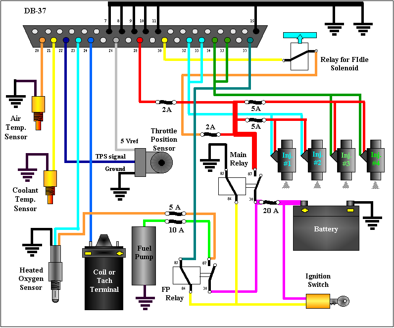

By Davids on Friday, November 12, 2004 - 01:53 pm:
Justin,
I put the IAT in the new intake closer to the air filter. I used the AFM harness to connect it and the O2 sensor to the MS.
Are you using the Megaview? Here's mine in an old floppy drive carrier. Fits nicely in the tray under the dash.

By Justin on Saturday, November 13, 2004 - 12:12 am:
My Pace exhaust manifold does not have a O2 sensor or a place to mount one. What O2 sensor should I buy? From my limited investigation a heated wideband (Bosch, NTK) sensor appears to be good for performance tuning. MS has some support for the NTK and Bosch wideband but treats the wide band as a narrow band, limiting its advantage but data logs to aid tuning, real time VE updating soon.
The Bosch LSU4 looks like a reasonably priced wideband sensor but the cable is more expensive than the sensor plus you have to buy/make the controller. Maybe I should just go narrow band?
By David S on Saturday, November 13, 2004 - 12:47 pm:
Justin,
I have the Pace extractors as well. I welded the O2 bung in the top section where the 3 pipes join on the RH bank. The problem is the O2 sensor is quite long but will fit in this position and is protected from damage.
I used a 4 wire NTK (to suit a VS Commodore) and ran the heater wire to the fuel pump relay and the sensor wires to the AFM plug.
David
By Justin on Saturday, November 13, 2004 - 03:24 pm:
David,
Do they look like this? Now I understand that other wire in your picture.
Did the NTK come with the controller or is it narrow band? Do you mind me asking how much you paid for it?

I connected the correct ljet pins to the ecu case as a "ground".. then connected the correct MS "ground" pins to the case too. Then when you bolt the ECU case to the car... it grounds it all too ! = No problems with dodgy grounds any more.

Like this? (my in-box LJet installation before I went to the pgitail and DB37)Steve R wrote:Well described Peter.
I connected the correct ljet pins to the ecu case as a "ground".. then connected the correct MS "ground" pins to the case too. Then when you bolt the ECU case to the car... it grounds it all too ! No problems with dodgy grounds any more.
Note the twisted black wires coming off the MS board (1-19) already installed inside the case to an eyelet connected bolted to the frame. The black ground bundle coming off the bolt is then soldered or spade-connectered to the L-Jet plug.
- Harness-Grounds.jpg (112.69 KiB) Viewed 13782 times
