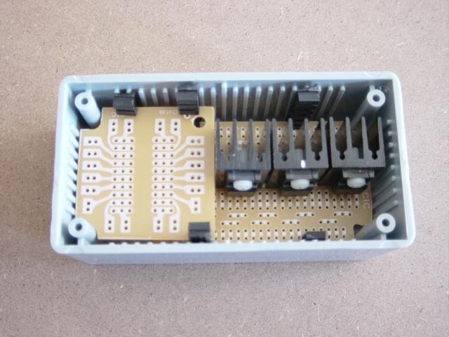

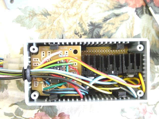

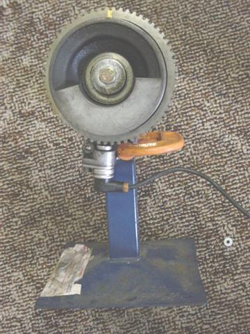

I have finished all the mods. I had to get the coil drivers from the US so the MS mods have slowed the overall project a bit. I also have only just located the ignition lead ends so that I can get a custom set of leads made to the correct length and to fit the coil pack.
Not sure why I went down this path other than to see if it can be done and to make use of the 164 toothed wheel. Cost of the mods was not much just the time involved. I have completed the following;
VR Sensor Circuit to read the 164 60-2 toothed wheel. This works and Megatune reads the RPM from the wheel.
Dual O2 Sensor Circuit using the dual spark tables in MS
3 X VB921 Coil Drivers to drive the coil pack direct, no distributor or module. This works on the dummy set-up but a bit hard to test fully without proper suppressed leads.
Modified Tacho Circuit as the coil will now not be driving the tacho signal. Testing will have to wait until its all in the car.
The coil drivers, mounted on heat sinks and the VR circuit were wired up on small Pro boards and housed in a small electronics project box as there was not enough room in the MS case.
I set up a dummy ignition set-up with a spare GTV6-Ljet wiring harness, combi relay, the 164 VR sensor and a coil pack. Looks a bit messy in the photo all in a heap but it did allow me to test most of the MS mods out of the car.
Everything is now set to put the completed 3.0L engine in the car and put it all together with the MS.
Here are some pics of the work so far.
David
