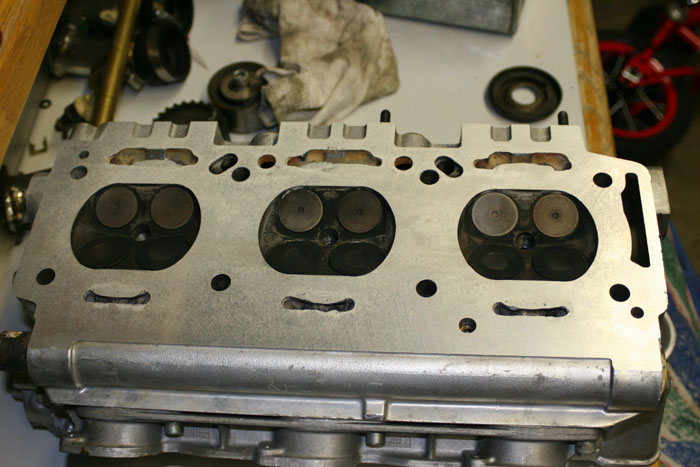

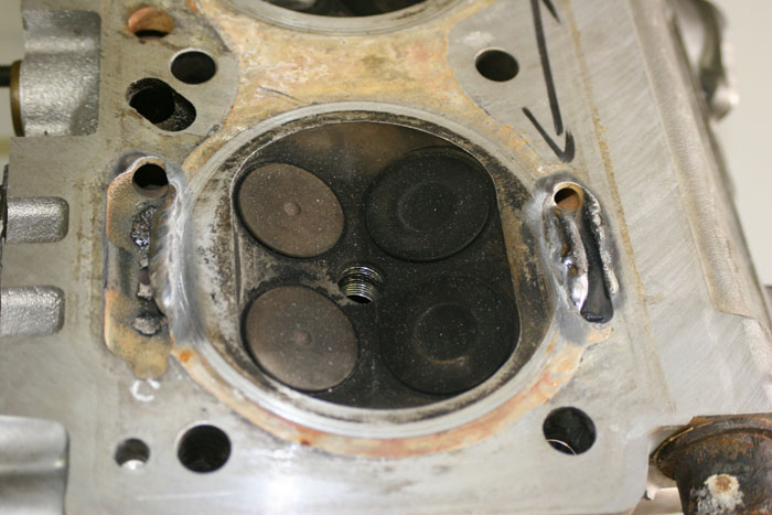

On this close up you can see where the rings bite into the head. I have this system using the identical cooper ring system on the 3.2 which has been running perfectly for four years and very reliably.
Nice one Kev !!
Get it back together now,the potential was eveident when I drove it..
Feel free to share the oil pump goodie..No secrets here.. :wink:
Pic of heads skimmed. One or two tiny pit holes but nothing serious in x -ray and nothing near where ring 'bites'.

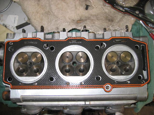

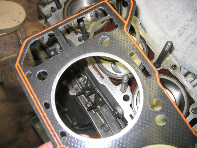

After two water leaks on the head due inaccurate machine work from my machinists I decided to go with a specially made head gasket. This has been a long process with the chaps making the gaskets. The first sets rings were not rolled correctly and did not have enough area to rest on sleeve. Once this was right the rings started to split so new tooling was made. Then finally the pressing were leaving slight indents on the ring when they were removing them. This would cause blow by . Also the water jacket slots had to be made into holes to match head with block. Finally the gaskets are done and are now perfect. Pics to follow
Re: 3.7 24v Build in 116 GTV
Pic of gasket lying loosely on the head. They are 100% accurate . I used the Goetze gasket to make the origional template.

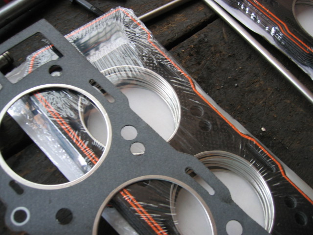

Its taken twenty sets just to get to this one . Here is a pic of twenty dud sets with incorrect ring thickness. Also is a pic of a blank without the shelac and silicone. Also the waterjacket hole were incorrect.

My other motors run with a simple ring thats sits on top of the sleeve and bites into the head with the surrounds of an origional head gasket used to seal off the water and oil. It works perfectly on all my other motors except for this one. Just thought I would try some thing different when you cant always rely on your machining chap. I prefer the origional method.
