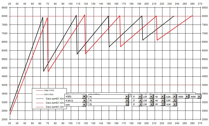

Made a couple of charts to show the difference in gearboxes and rpm (i.e. shift-points)
Kevin: You need to look at the specific track and try to match the corner speeds to the gearset, very difficult to give advice without having corner for corner speeds. I'm in the same kind of hell myself right now in trying to decide but since I'm redoing my whole car I have no starting point what so ever. :?
Maurizio: Stock TS have a rev limiter of 6300rpm, right?
From my very limited experience I'd say that an LSD on the ring with a stock TS engine is totally unnecessary, no slow tight corners in sight! Likely hood of a torque related loss of traction in high speed corners = 0. :wink:

The calculator needs a tyre circumference input to be more accurate. Not all tyres are the same based on the aspect ratio alone.
Re: LS unit spiggot size - HELP !
Close enough :idea:
