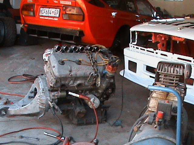

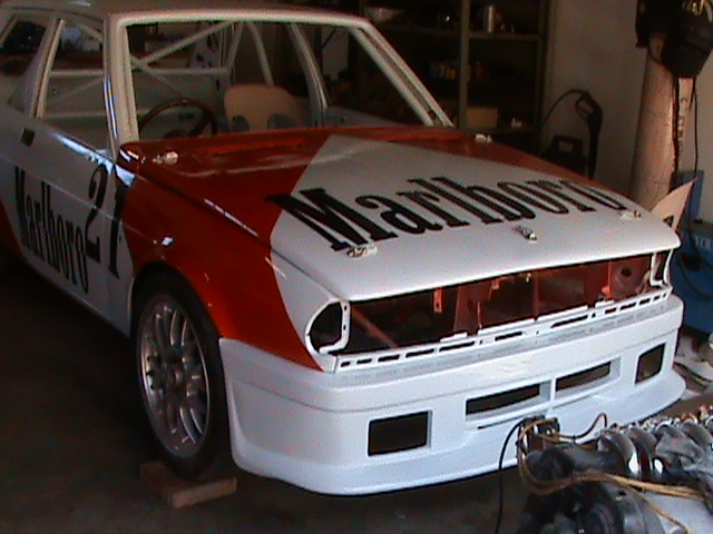

Frosti, hows the car coming on. Post some pics. The Giulietta build is getting there but also pretty slowly. The car will probably take another two months. Here some pics to get you motivated. The bonnet touch the plenum so used 155 plenum tubes that bolted straight on. Trying to align 156 starter today to make bracket.
front malboro.JPG (152.48 KiB) Viewed 9557 times
motor malboro.JPG (147.49 KiB) Viewed 9560 times

Kevin- Do you ever sleep?
That Giuli looks great, by the way- appreciate the plenum pics when it's done
