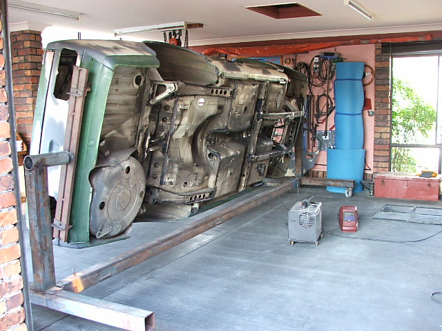

Well, it is a big job and you need one of these things if you want to do it fully. I made the rottisserie to start with. If you have a hoist to use at your leisure, that's almost as good but not quiet.
You need to pressure clean everything first. Strip off the body protection materials with a heat gun and scraper. If you have a mobile sand blaster, you can blast off the paint tracks along the seams to get a clean weld going. Otherwise, a small angle grinder will get the job done too.
When welding, just do short runs along the seams about 10mm long and the same length apart.
I used a MIG.
I used a MIG.

Sweet unit, MD!
Re: Seam welding - GTV6
Thanks.
A very useful tool. Its on castors so you can roll the shell anywhere like onto a flat bed truck for transportation to other work sites like, the paint shop, pressure cleaning bays etc. While at the paint shop, its useful to paint the whole underside of the chassis and the interiors for ackward angles. Also great for welding flow where it would normally need to flow "up-hill" which is otherwise tricky to get right unless you are a skilled welder. Handy when building the roll cage too.
