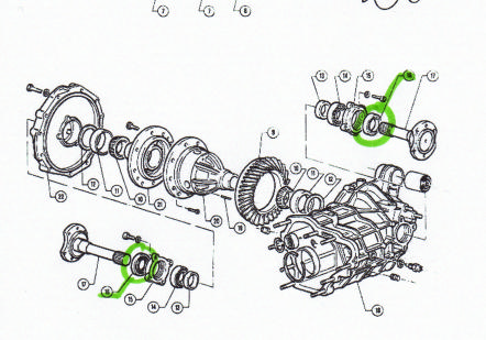

Anyone have a part number for the milano stub axle oil seals (one on each side)??
THANKS, I need four.
Need a parts number
- stub axle seal milano transaxle.jpg (69.94 KiB) Viewed 5159 times

60521231
That's the number i found on a 75 3.0 gearbox part list....
I just cannot see the need for 4 of them..
www.tuynder.nl
>catalogus
>alfa romeo
>75
>v6
>aandrijfassen en toebehoren
>differentieel achter
nr7 is the part.. "keerring"

Some of us have more then one gearbox. I think I have about four, three of them working and with different ratios.

Be sure to go genuine with these seals. I recently replaced a set on one of my boxes. They need to be of the right material to deal with the heat from the brakes. I think they might be made of a Viton material but not certain.Any old seal of the correct size wont do. They are also not cheap !!

The material could very well be Viton for those seals. The best seals for crankshafts and camshafts are also made of it.
A Viton seal is up to 5 times more expensive as a NBR seal. But the dealer price is even more expensive.
I work at a industrial wholesaler (we sell everything for industrial use, bearings, seals, tools...) and i can get most seals from our supplier for very good prices... But only if they are a normal size... Rear crankshaftseal on the v6 is a strange size, got that at the dealer and paid 22 euro's for it, front seal was a normal size and cost me 1,50 euro.

ummm...yep. I have four t-axles...rebuilding, one LSD, and rebuilding two. I was able to get some from Centerline...not on the website. Thanks for the part number. BIG help.

15$ at Alfaparts...7$ at Centerline. OE quality....??
