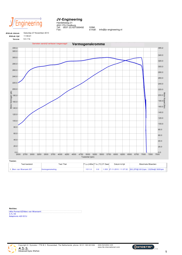

finally today after all work has been done, the car was dynoed.
the car goes like hell :shock: 100Hp more than standard is a LOT!
marcvermogenscurve 2.png (98.74 KiB) Viewed 13233 times
Re: introducing myself
Nice! 300pk at the wheels is about an F355, and more than the E46 M3. What compression ratio does your engine have?

it is at the crank! compression? i don't know :roll:
Even at the crank, that's a lot. Plus, look how flat the torque curve is, this car should really move.
Zamani wrote:Nice! 300pk at the wheels is about an F355, and more than the E46 M3. What compression ratio does your engine have?
The lame US Spec M3? Euro is 343Hp (crank).
US spec E46 M3 is 333 bhp, due to headers and other smaller differences. 10 bhp difference, not too lame I think.
Originally I thought it was 300 @ the wheels. M3s only have 270-280 at the wheels. F355s have around 280-300 at the wheels depending on dyno yada yada.

i've had it dynoed again somewhere else where we got 350 hp crank.

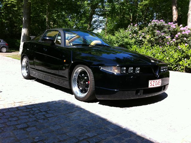

sz klein formaat.jpg (87.56 KiB) Viewed 12976 times
