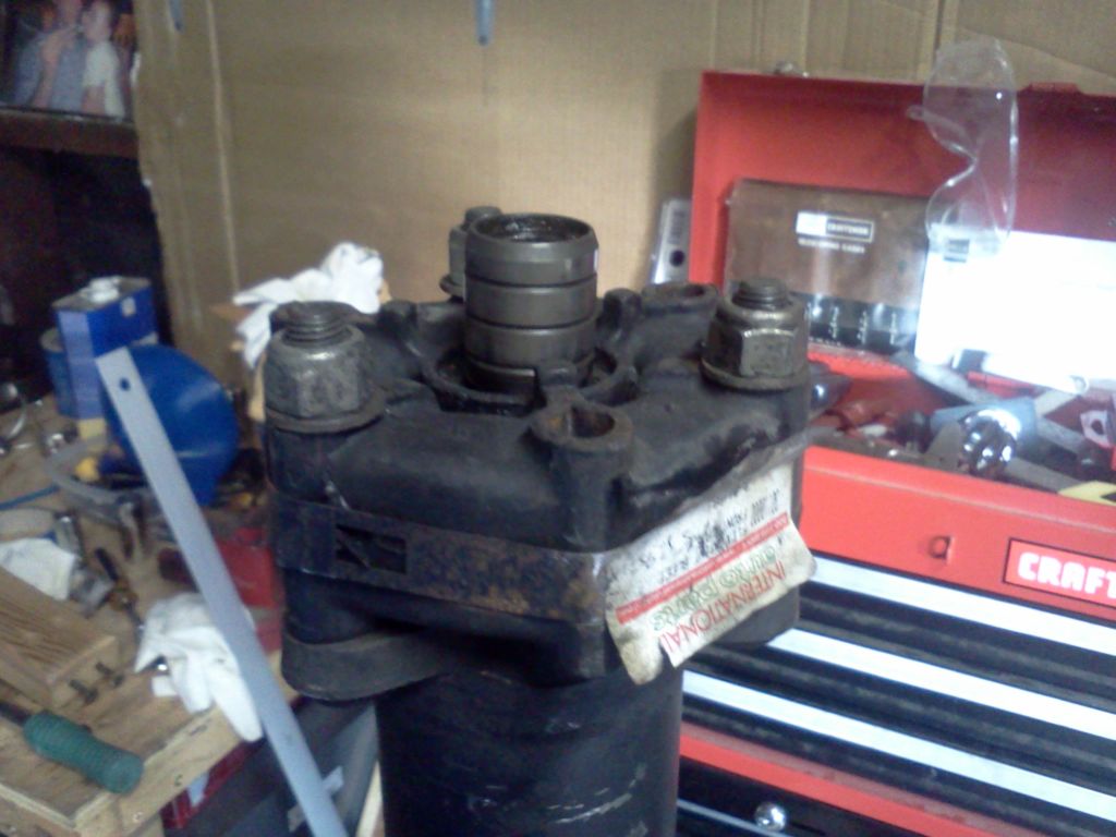

Any chance that this little object on the front of the driveshaft would also cause a rattling noise? Is it the locating bearing mentioned a few posts ago.
(trying to add attachments but not seeing it in the preview. Here goes)

Files were too big. Here goes.
- frontDonut002.jpg (97.92 KiB) Viewed 6634 times
- frontDonut001.jpg (105.31 KiB) Viewed 6634 times

Re: Suspected clutch rattling noise
Could be possible, as long as there is too much play, there will be noise.
