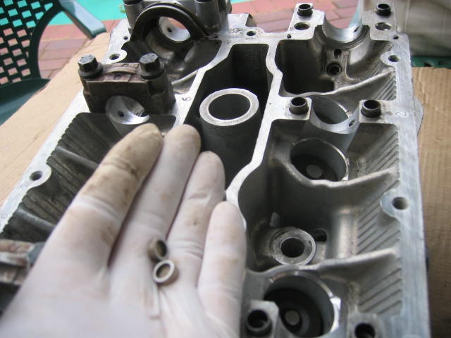

In these heads, valve lift is limited by spring coil bind and retainer/guide seal contact to a max of ~10,3-10.5mm. you can regrind the existing cam (without welding new lobe material) to obtain 10.4mm lift, but you would overextend the hydraulic follower by the amount you would reduce the base circle. For 10.4mm lift, the grinder said he'd have to shave ~1.6-1.8mm from base and he thought it would be borderline, meaning it may not work. I didn't like this possibility so I stayed with a 100% safe 10mm. Next time, I will have to look for Maserati valve adjusting shims (7mm?) which I think can be placed on top of the valves, under the follower; but this is only a thought now. How far out do you think the follower can be raised out of the bore and still be reliable? I don't have any info on this. Has anyone experimented with under-ground hydraulic cams?

When I used my cut cams I stripped the hydraulic lifters and got all oil out so they could collapse easily if compressed . I put them back in head with standard cam and measured gap when I pressed them down with thumb . I then did this with my cut cams and added a 1 mm shim to get the same gap . Only reason I did this as I heard stories from guys who never did this who raced . But then again you should believe everything you hear at the track .
Re: My engine 3.0 V6 24V
That's clever Kevin! So, my idea about Maserati shims has already been verified!

On my other 24v engine I had the valves lengthened by by 1 mm as this technique is now bullet proof . I did this to reduce extra weight flying around above valve as this was a smaller much higher revving 3.0 24v . When I compare prices what I paid in SA to do this to uk it frightening and it was done by the top BMW Motorsport team who do work for all cars as the owner did race Alfas about 30 years ago . ( vanderlinde)
I'd feel pretty comfortable with 1.5mm shims over the valve. As it is now, it'll go to 7800 with std parts. With proper (a little uprated) springs there wouldn't be any problem at all. Besides, I think 7500rpm for the 3.2 should be fine for any use, if the intention is to also drive it on the street -a point I personally insist on.
