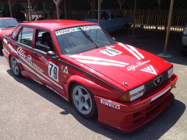

I took some pics a while back of a homologated independent rear Dedion on this ex race 75 . I understand it was only homologated for the Italian series .

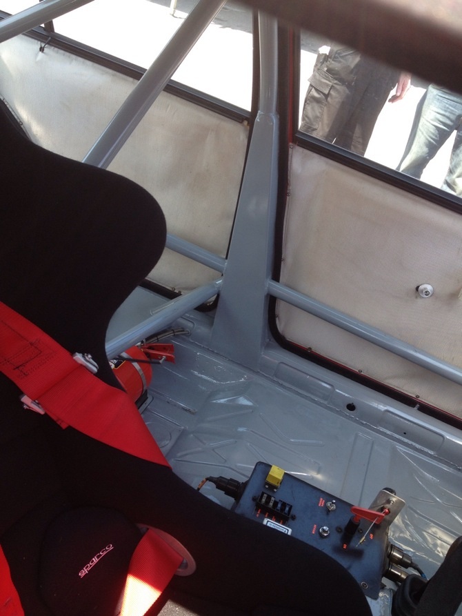

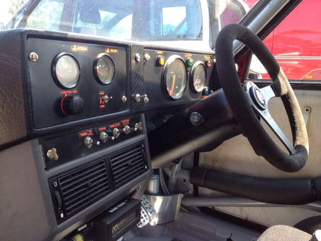

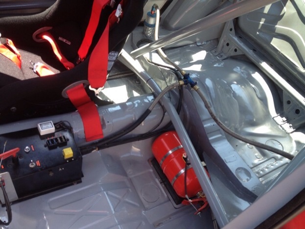

Some pics first of car and interior before underside .

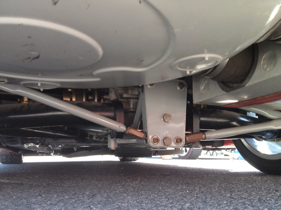

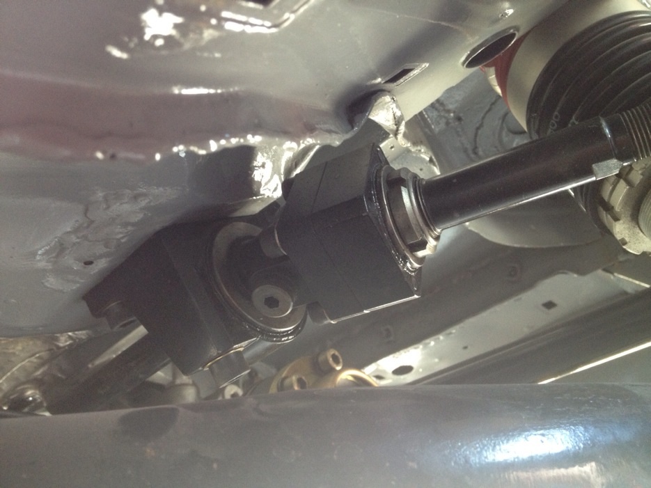

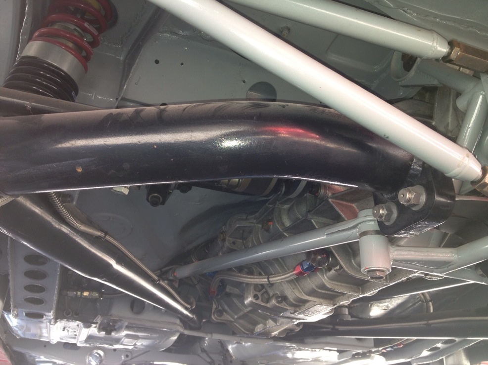

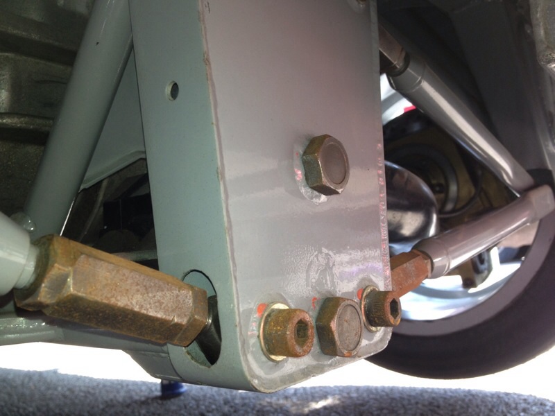

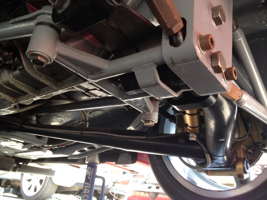

Rear suspension . Note blades are used on rear pivot point .
Re: Independent Dedion - Francia/Schlesser 75 Turbo

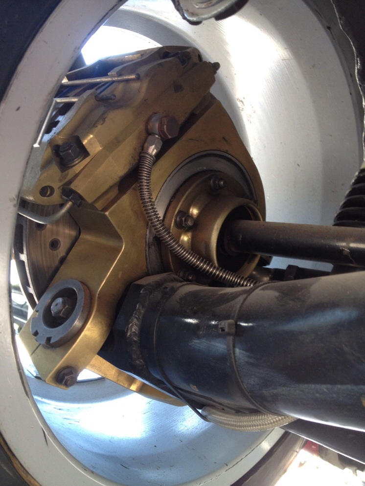

Four wheel steering :shock:
The rear anti roll is connected through universals to the toe adjustment on hub .

the Francia/Schlesser version has a lot more in it then just adjustable camber and toe...
It was a factory trick to let it appear to be a adjustable dion, but it is a independent rear suspension. 8)
(So left side movement doesn't influence right)

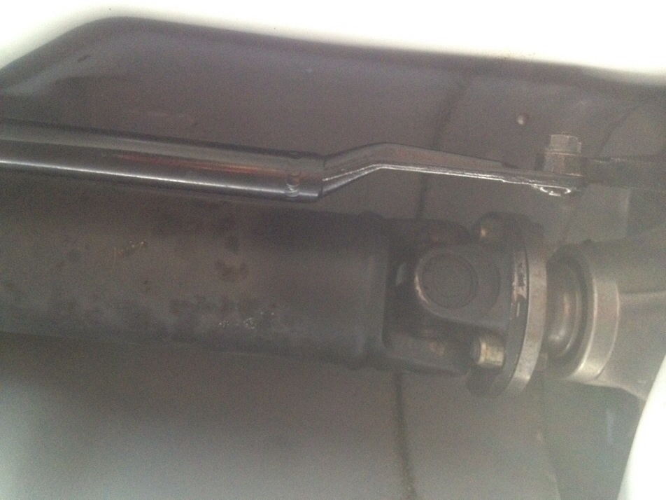

Love to see more driveshaft pics....

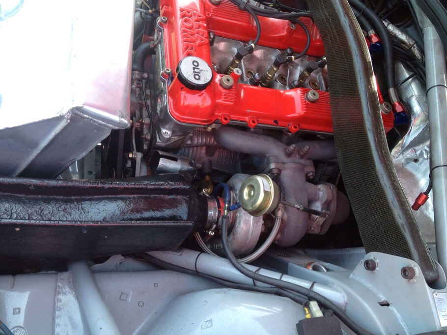

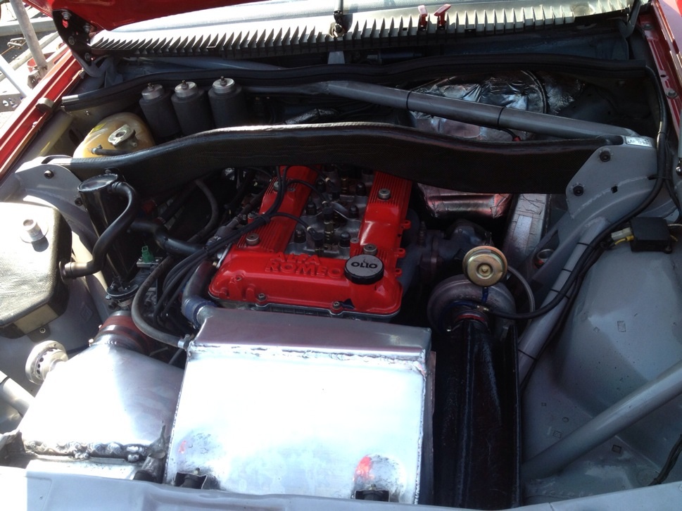

Some more pics I found on my phone of this car . Interesting charge cooler set up .

Been staring at this pics for the last couple of minutes trying to figure out what the hell is going on...
I don't think it's 4 wheel steer - or adjusting the toe - I think it's using the link from the end of the sway bar to the upright as an upper link - stopping it from behaving as a swing axle setup, and making it into a proper Short and Long (very long) Arm suspension - clever use of existing mounting points (would also explain why the roll cage is heavily braced to the sway bar mounting points!).
The chargecooler setup doesn't look that out of the ordinary to me, except for the horrendous welding on the front edge of the end tank.
I'm curious as to what the door trim material is though.

Ben,
I think they MIG welded aluminum.
