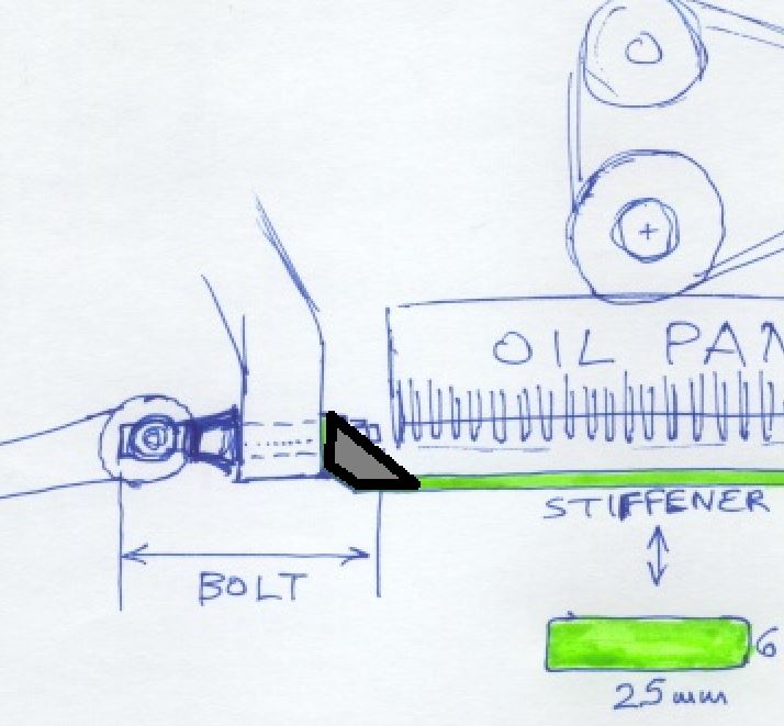

Not optimal, but already better.
Quick drawn ... preferably on both sides of the strip (around the bolt).

Hahah! I thought of that when I made the strip, but there is no way to tighten the nuts... No access as you can't fit a wrench or ratchet. The oil pan is in the way.
Maybe we have to design something 'U'-shaped to fit on the rail with a hole for the long existing bolt.. The bottom (horizontal) part of this will have 2 threaded holes for short bolts to fix the transverse ~8mm thick stiffener. We now have the advantage of a removable flat single-plane stiffener connecting the rails with 2 bolts per side. Think about it!

Here's a sketch of what I consider a simple and effective (?) fix to the problem. Ideally, there should be two such assemblies for the front and aft LCA bolts and maybe a rigid connection of the two bars underneath?
I asked again for long Allen bolts and they are not available >120mm in fine thread (1mm) but only in 1.5 and 1.75mm. I searched the net, same story.
I'm surprised you guys haven't run across the same problem with your cars!

Then some remarks on your stiffener sketch.
So I see again a U shaped (two folds) in each bracket, so you do not generate any stiffness. Thickness of the U's?
What I'm not sure of... are you going to weld these into place onto the outside of the chassis members?
If so I'm still not convinced it is the best idea, but is already ok-isch.
To get this more to my liking
Would you consider opening up the chassis member and put in a solid square block, instead of the alfa original crush tube? And weld it into the chassis member?
If so... we have to work this out a little better
Then for the bolts to secure the connection strip between the two members...
What thread diameter are you thinking about?
General bolt connections:
For a good bolt connection you need at least 3~4 bolt diameter free length, between head and the first engagement of the thread. Long story short, compensate setting behavior and leaving enough elastic pretension in the bolt. What you are sketching here isn't going to stay in place very long!
I'm not sure if this is understood correct, will make a sketch tomorrow night.
Don't have the right drawing tools / time right now
