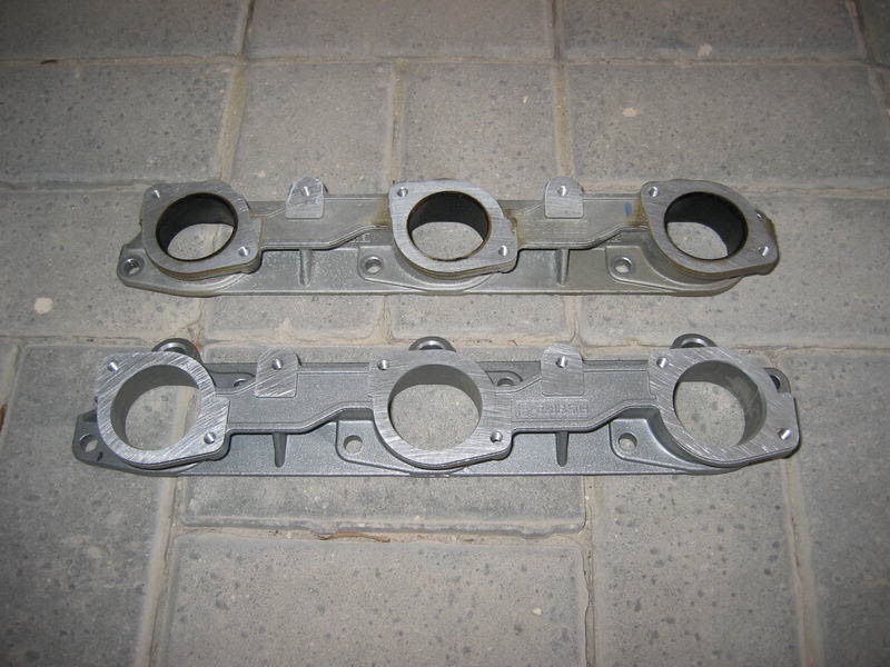

Re: 24v Intake Runner Base Plates
Found this photo on the alfa156.net forum....
I guess that answers my question. Thanks all.
- image.jpg (124.4 KiB) Viewed 14149 times
I don't think there is much difference in the base plates.maybe between 2.5 and 3.0 there is a difference?
If you look at the chrome runners you'll see a small taper just before the flange (this applies to the smaller diameter runner,the bigger runner has no taper).I believe the hole in the flange is the same.
I think there is a minor difference between the 2.5 24V and 3.0 24V base plates. You can confirm with Stephan Lenoir, but I believe he was selling modified 24V base plates for 156 V6 owners wanting the 45mm runners. Most likely the difference isn't too big and machine shop can fix that.

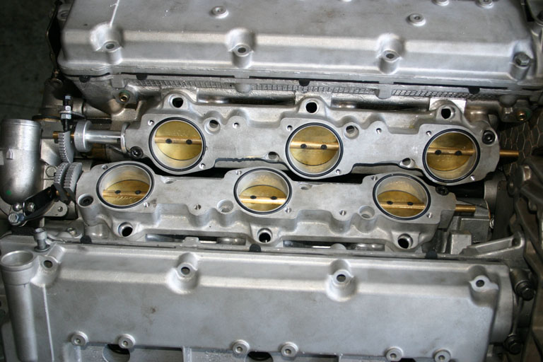

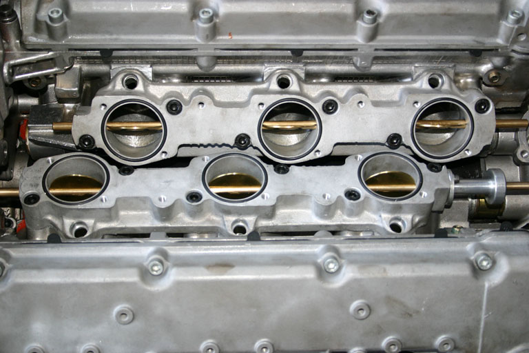

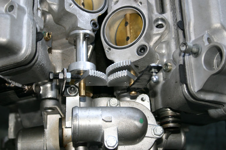

Perhaps this is a bit offtopic, but ...
I've seen these throttle bodies on Alfabb.com.
Is it possible to drill in half the original intake base plates, add bushes and throttle blades and do something similar?
