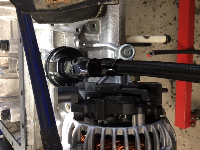

Another option for those interested in keeping the later hi output alternator is to remote mount the filter. It still means drilling and tapping the block but also means the the filter is now easily reached
