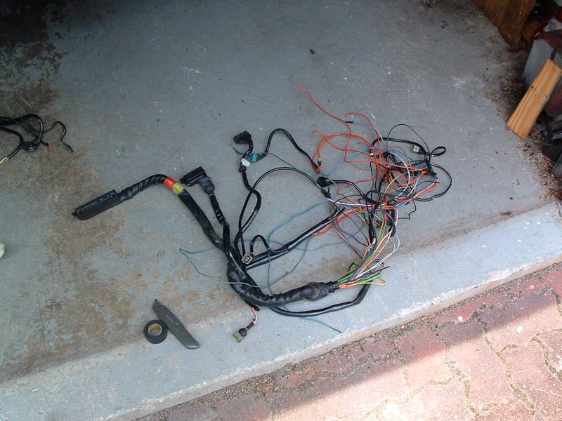

Splicing the original WH
OK, I spent Sunday pulling the stock harness out of the Verde and splicing it to the GoTech harness. I think I have most things done, it looks like I can keep the cold start injector since it works off the TTS and not the ecu, so I will leave that plugged in. I got Greg's new injectors installed. I could never figure out how the fuel pump worked off the AFM unless the signal ran backwards through the combo relay. I am keeping the combo relay and the stock wires for the coolant gauge.

The reason I did it was for the connector to the coil, they are made into the harness, the iginiton power module, the relay for the ecu, the relay for the FP, the power line for the AAV, the temp sender for the gauge, the power lines to the o2 sensor, that and the CSI system. So there are about 10 wires I brought over from the old harness, most of it is going away, I just wanted to use what I could, that way I know my relays are hooked up right...
OK, since my electrical engineer (DaveH) agreeded with you, I will ditch the CSI system, next time one of the East Atlanta Alfa V6 club members has a CSI issue, we can swap out with mine...

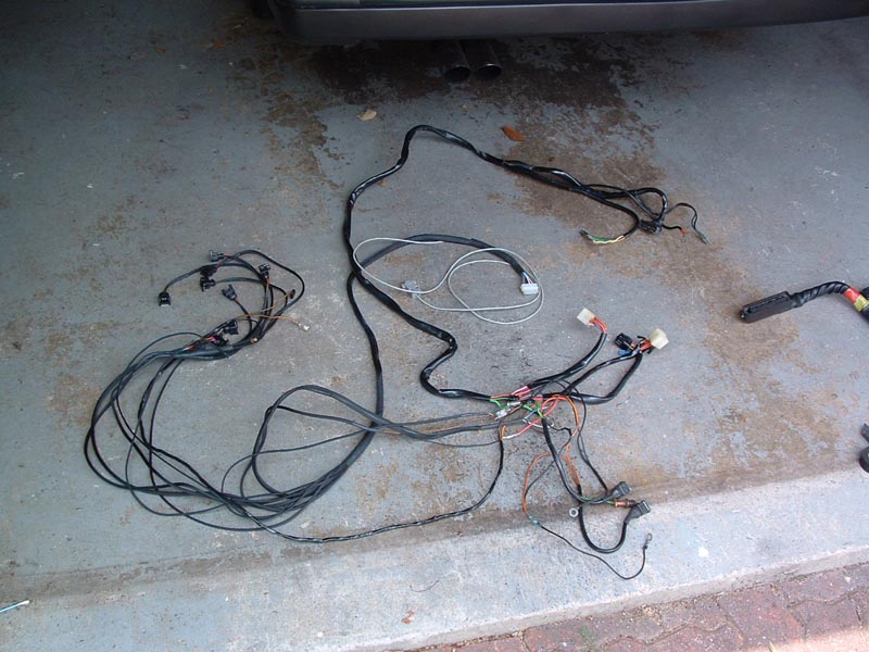

Here is a picture of my harness, I have things group as to where they go, I will plug in tomorrow.

I've found that it is better most of the times to completely pull out the existing engine harness and install the Gotech harness. This will eliminate bad joins and make the engine bay neater as well.
On new vehicles we tend to keep the old harness in positon and simply splice in.
At the end of the day it all comes down to what you prefer.
