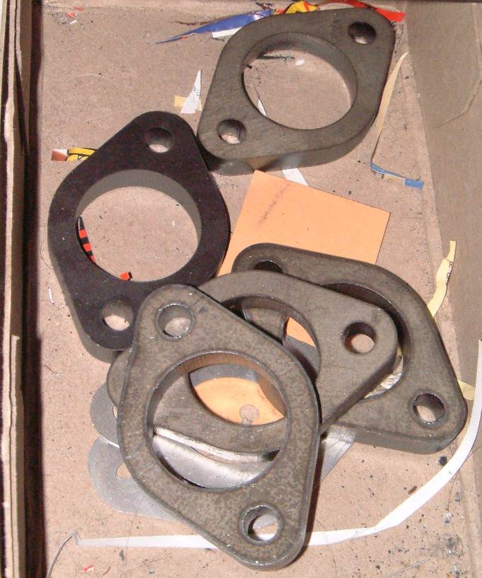

I might have something lying around, did cut a lot of flanges a while back, 2", 2.5" and 3".
The shipping would be a beatch though. :?

Mats,
What's the thickness? Shipping shouldn't be too bad actually.

8mm. May have gaskets too. :wink:
Is 8mm thick enough for downpipe use? Or will it warp? I think for N/A cars the exhaust temp won't get too hot. But I was told, anything close to the headers should at least get 3/8". But 8mm is closer to 1/4".

last month i ordered some laser-cut flanges (they are 1.5") and paid ~10$ each...i send them a drawing...
