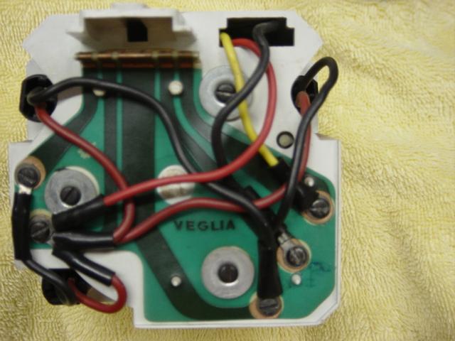

I've attached a picture of my speedometer.
As far as I can tell, the wiring is:
1: Turn Signal (+)
2: Ground
3: Dash Light (+)
4: Dash Light (+)
5: Speedometer Signal (+)
6: Speedometer Power (+)
Is this correct? The problem I'm having is that when I turn the dash lights on, wires 3 and 4 have no power to them. They should if this wiring diagram is correct.
The wire that goes to 3 (or 4, it shouldn't matter) is connected to the dash light power from the clock (I tested with a multimeter for conductivity), but the power isn't getting sent to the speedometer. Any ideas for why this would happen? Thanks a ton!
Carson
P.S. The missing bulb is there, it was just out for the photo.
1: Turn Signal (+)
2: Ground
3: Dash Light (+)
4: Dash Light (+)
Carson
- speedo wiring diagram.jpg (87.33 KiB) Viewed 4917 times
Looks like you have the new style speedo. Has this been changed in your Alfa from the older style? Not sure if the six space five connector and six space six connector types are interchangeable.
Also, I noticed on mine that the speedo wiring from the rear is also different (1985..compared to older models...not just the lighting)
