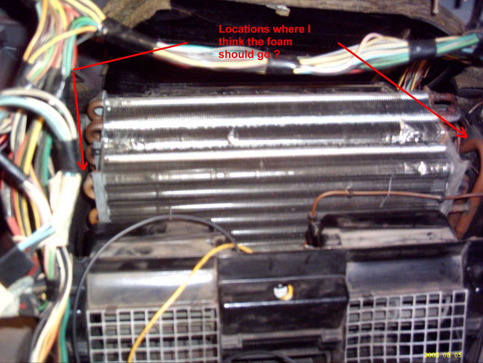

Can anybody suggest exactly where this foam should go ? Between the sides of my evaporator/heater core and the heater box there is very little room due to all the bent tubes.Plus my way of looking at it is that these tubes are either hot or cool so why not let the air being drawn by the fan go through them ? The only way I could forsee doing this would be by using building foam in an aerosal can and I'm hesitant to try this.Anybody got an opinion ?
Excuse the crappy photo.
Hi Murray
Thats exactly where I put it. I just used seat cusion foam, whatever fits....as long as it can't catch fire.

Thanks Greg.Now can anyone suggest what the advantage of blocking off these areas could be ?
Hippo58
Posts: 49
Post by Hippo58 »
Hi Murray,
As Greg says in the above quote you put the foam on the sides to prevent the air bypass the heater core.
In order to get the hotest/coldest air, the air(!) has to pass from the aluminium fins of the core (logicall). That path is very restrictive though and quite a lot of the total amount of air passes from the sides of the core which is MUCH less restrictive. Although the pipes at the sides are indeed hot/cold the efficiency of this path is nowhere near to the path through the aluminium finned core.

Yes Petros your explanation is perfectly clear.Thanks.I'll go ahead and give it a try.
