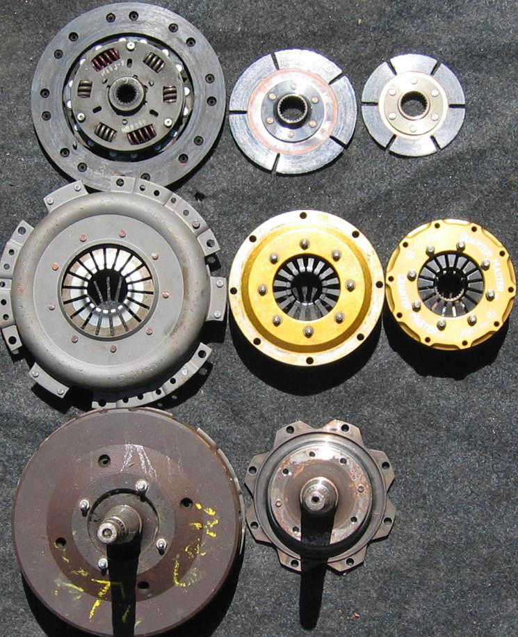

I just got my new clutch and shot some photos.
There has been discussions about lightening the rear flywheel. In the pics my old lightened flywheel is in comparison to the new one. For records the old one is lightened from 7.5 to 5.2 kg. The assys and the disk plates are there as well.
I didn't decide yet whether to use the 4.5 or 5.5" clutch. Both are capable of 1100 Nm :shock:
The 5.5" I'll machine down to 2 disk and the smaller probably as well. Neither is a bolt on but can be made to fit with pretty decent work. The flywheel weighs 952 g for the 5.5" clutch and the smaller one will be just under but I don't have it yet. I won't bother you with inertia but is is LOW.

Micke exelent work :D what material and what thickness of 900 gr flywheel ?
Flywheel is steel. Thickness varies all over the thing.

Micke wrote:With 1100 Nm capacity in my 1.86 NA engine ...
1.86 ? 155 1.8/1.7 ts 80mm stroke crank + overbore pistons or somethink more exotic :?: :D

75 TS. 85x~82
