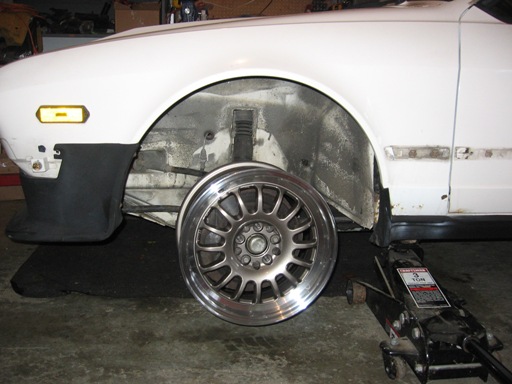

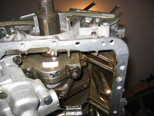

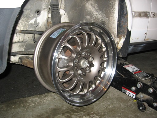

DID some engine work converting 164s to gtv6. No one mentioned that you have to drillout about ten bolt holes for the pan bolts. Also, front lower engine cover fits the crank pulley, but needs to be drilled for pan bolts. You can only get 3 out 0f four in place due to casting. Should seal up allright, though..
Received my ROTA rims today.
all I can say is HOLY CRAP, THESE ARE AWESOME!!! They will need a set of deep lug nuts as the capped ones bottom out ...
see pics..
cleaned and ready to go

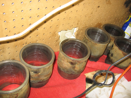

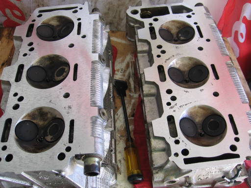

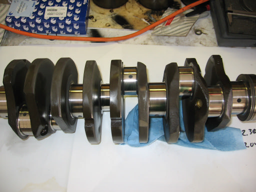

more pics...blue cause of photo shrink not working right..
extra holes to drill
cleaning and honing
cleaning and honing
7 thousandths off
7 thousandths off
micro polish..dead on blue!

Rim pics:
total weight for two thick boxes and straps and two wheels is 28lbs...so I am guessing each wheel weighs ~13 lbs.
